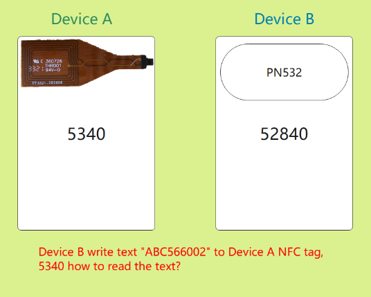

NCS1.9.1, VSCode, nRF5340DK cannect a NFC tag,
i write text to NFC tag by Adafruit-PN532 with anouher device,
than 5340 mcu how to read the text in NFC tag?

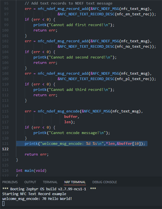

thanks for reply,
\v1.9.1\nrf\samples\nfc\record_text
no cannect NFC ant tag,

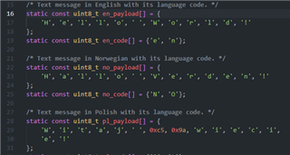

Where does this text "Hello World" come from ?
Best regards
Should be higher up in the file, look for en_payload[].
Kenneth
sorry,
I thought the text was on NFC hardware and didn't notice here.
is it means: MCU can write text to NFC tag, but can't read text from NFC tag?

Can you share a drawing, block diagram or picture of your setup, and what you are trying to do, this is not clear.
Kenneth
Best regards
I believe you may need to look at one of the examples that support write, for instance the writeable_ndef_msg show use of both NFC_T4T_EVENT_NDEF_UPDATED and NFC_T4T_EVENT_NDEF_READ. See nrf_t4t_lib.h for information about the events.
