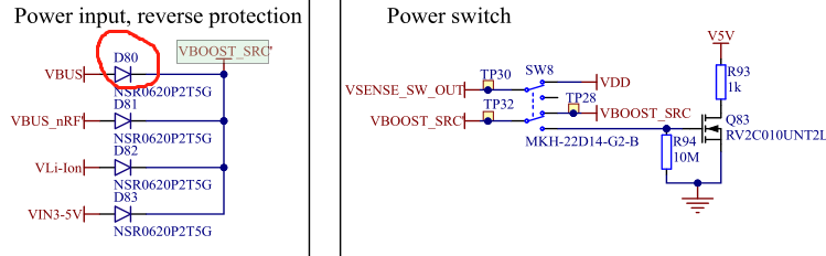

I have a question of my "PCA10056 boad", The VDD_NRF voltage is only 1.7V when connect microUSB of J2, I think one of my board components is broken, can you gei me some suggests。

My first guess would be that UICR has been erased and the high voltage regulator(REGOUT0) is set to it's default state of 1.8V.
Do you have a J-link pro or similar debugger that you can use to read the content of UICR?
Does UICR refer to 52840? when connect microUSB of J3, The nrf52840 can work and the volatage of VDD_nrf is 3V, In addition, I don't know other methods to read the content of uicr except through microusb of J2.
according my test,when connect microUSB of J3, VBUS_nrf is 4.7v,VBOOST_SRC is 4.5v,VDD_nrf is 3v,they are normal.when connect microUSB of J2,VBUS is 4.7V ,VBOOST_SRC is only 2.35v ,VDD_nrf is only 1.75v. According to the schematic diagram I think mybe the diode of D80 is broken,by testing ,When powered on, the voltage drop across the diode is as high as 2.3V, resulting in vboost_ The SRC voltage is only 2.35v, but when it is not powered on, the tube voltage drop is 0.27v, which seems to be normal again . So now I don not konw what is wrong.

In order to read the UICR you'll need to power the device via J3 and use another j-link to connect to your device via the debug-in or P20 connectors.
