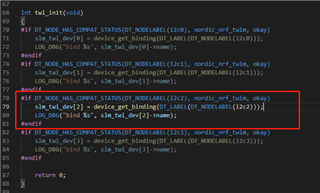

Thank you very much!!! I now understand how it works.I have one more question.
config SLM_TWI bool "Access TWI interface with SLM AT command" select I2C default y if "$(dt_nodelabel_enabled,i2c0)" || \ "$(dt_nodelabel_enabled,i2c1)" || \ "$(dt_nodelabel_enabled,i2c2)" || \ "$(dt_nodelabel_enabled,i2c3)"How to enable "dt_nodelabel_enabled,i2c0 ".I didn't find a reference.
See zephyr/scripts/kconfig/kconfigfunctions.py#L124-L136.
You enable it by setting the "okay" as from my last post.
status = "okay";

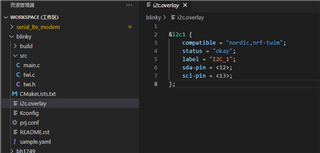

I tried the following.
Either i2c0 or i2c1 is enabled but i2c2 is enabled.Am I still wrong somewhere?
Hi Sigurd Hellesvik:
This is the project I built, and it seems that I2C is not working after running.
Hi
The overlay file will not be added just because you have it in the same folder.
See Set devicetree overlays for how to set it.
Sigurd Hellesvik
Hi
