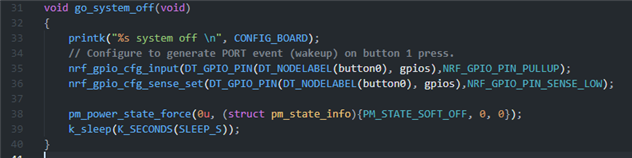

NCS system off fast
NCS1.9.1, VSCode ,nRF21540DK,
i want to system off fast,   but
after clicking the button1 many times, it cannot be restarted/awaken.

void go_system_off(void)
	const struct device *cons = device_get_binding(CONSOLE_LABEL);
	printk("%s system off doing\n", CONFIG_BOARD);
	/*if (IS_ENABLED(CONFIG_APP_RETENTION)) {
		bool retained_ok = retained_validate();
		// Increment for this boot attempt and update.
		retained.boots += 1;
		retained_update();
		printk("Retained data: %s\n", retained_ok ? "valid" : "INVALID");
		printk("Boot count: %u\n", retained.boots);
		printk("Off count: %u\n", retained.off_count);
		printk("Active Ticks: %" PRIu64 "\n", retained.uptime_sum);
	} else {
		printk("Retained data not supported\n");
	// Configure to generate PORT event (wakeup) on button 1 press.
	nrf_gpio_cfg_input(DT_GPIO_PIN(DT_NODELABEL(button0), gpios),NRF_GPIO_PIN_PULLUP);
	nrf_gpio_cfg_sense_set(DT_GPIO_PIN(DT_NODELABEL(button0), gpios),NRF_GPIO_PIN_SENSE_LOW);
	printk("Busy-wait %u s\n", BUSY_WAIT_S);
	k_busy_wait(BUSY_WAIT_S * USEC_PER_SEC);
	printk("Busy-wait %u s with UART off\n", BUSY_WAIT_S);
	int rc = pm_device_action_run(cons, PM_DEVICE_ACTION_SUSPEND);
	rc = pm_device_action_run(cons, PM_DEVICE_ACTION_RESUME);
	// printk("Sleep %u s\n", SLEEP_S);
	// k_sleep(K_SECONDS(SLEEP_S));
	// printk("Sleep %u s with UART off\n", SLEEP_S);
	// rc = pm_device_action_run(cons, PM_DEVICE_ACTION_SUSPEND);
	// rc = pm_device_action_run(cons, PM_DEVICE_ACTION_RESUME);
	printk("Entering system off; press BUTTON1 to restart\n");
		// Update the retained state
		retained.off_count += 1;
		retained_update();
	/* Above we disabled entry to deep sleep based on duration of
	 * controlled delay.  Here we need to override that, then
	 * force entry to deep sleep on any delay.
	pm_power_state_force(0u, (struct pm_state_info){PM_STATE_SOFT_OFF, 0, 0});
	/* Now we need to go sleep. This will let the idle thread runs and
	 * the pm subsystem will use the forced state. To confirm that the
	 * forced state is used, lets set the same timeout used previously.
	// printk("ERROR: System off failed\n");
	// while (true) {
	// 	// spin to avoid fall-off behavior
periodic_sync_off.rar

  • Hi,Simon,
    in main() ,when button pressed,will break while,
    and call   go_system_off();
    I tried system off five times and couldn't wake up again.
        press button to go_sysytem_off
           press button  to wake up ok
           press button can't wake up
    when i change to as follow:
        k_timer_stop(&my_timer);
        bt_le_scan_cb_unregister(&scan_callbacks);
        bt_le_per_adv_sync_delete(sync);
        bt_le_scan_stop();
        go_system_off();
    problem solved.
