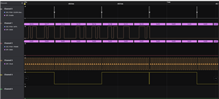

On a NRF52840, I try to perform `x` SPI transactions of 3 bytes each using EasyDMA Arraylist feature fully controlled by hardware. The CS must be toggled between each block of 3 bytes so I use CS HW of SPIM3.
Example of a transaction:
I need everything to be hardware controlled as SoftDevice is running and has higher interrupts priority than my app, I do not control the software timing precisely. My slot window is very tiny and a precise timing is required.
The start is not a problem, triggered by a GPIOTE but I don't know how to stop the SPI in hardware.
Here is the code I tried:

It does not work as expected, it pauses but after sending a byte. I think this is due to short of SPI being executed before PPI, right? From datasheet, chapter 6.1.7 Shortcuts:
> [...] However, the propagation delay through the shortcut is usually shorter than the propagation delay through the PPI.
Transaction example:
Then, the SPI block seems stuck, calling `NRF_SPIM3->TASKS_STOP` in the app has no effect, the CS remains asserted. Also I cannot start another SPI transaction. Why calling `NRF_SPIM3->TASKS_STOP` or `NRF_SPIM3->TASKS_RESUME` has no effect, how to unlock the SPI block?

    The reason why NRF_SPIM3->TASKS_STOP doesn't work in your application is that this task also generates the EVENTS_END event, which will trigger the next start task for the SPIM3. Using PPI to toggle a GPIO on the events end looks like this after you trigger the TASKS STOP:
    Where channel 4 is the pin that toggles on the EVENTS_END.
