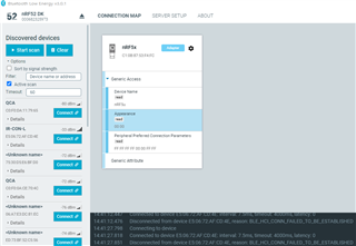

  • I use NRF52 DK board,The MAC address of the NRF52 DK board is fixed,I added the MAC address of the NRF52 DK board to the server whitelist, NRF52 DK board can not connect to the server.Is there something not configured?
    Print the following:
    14:41:27.798
    Connecting to device
    14:41:27.818
    Connected to device E5:06:72:AF:CD:4E: interval: 7.5ms, timeout: 4000ms, latency: 0
    14:41:27.851
    Disconnected from device E5:06:72:AF:CD:4E, reason: BLE_HCI_CONN_FAILED_TO_BE_ESTABLISHED
