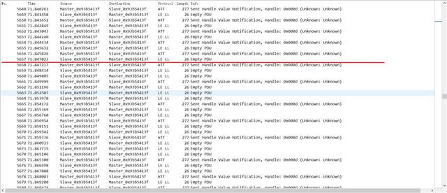

I am testing the ATT MTU throughput test provided by nRF5 SDK and I found the throughput could not reach the theoretical maximum 1.4Mbps.

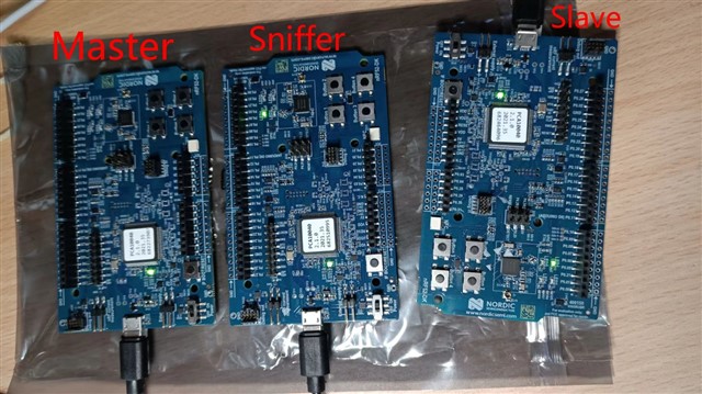

Hence, I used the nRF Sniffer to analyze, and what I found was that after a certain stage there would be multiple ACKs after an ATT MTU data package.
The thing is that when there was only one ACK, the throughput was about 1.37Mbps ≈ 1.4Mbps. However, when there were multiple ACKs, the throughput was only about 0.6Mbps.
Right now, I suppose that these redundant ACKs were causing a reduction in the throughput, and they were happening almost every time. What could be the cause?

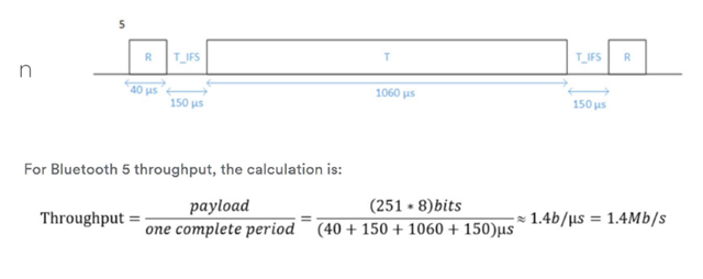

Here is how I calculate the max throughput and also other throughput:
Really appreciate it if this could be helped.
