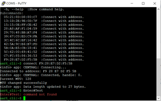

  • Hello
    Thanks for the help. Now it works normally. But still can't send command to device.
    Should I add a new command to send command or I can just modify something to send command?
    Thank you
    Here is the code I modified.

  • Hi
    I think it makes sense to add some additional commands to support the additional functionality that you want to add to the example.
    If you take a look at the cli_m.c file in the project you can see how the existing Bluetooth commands are set up, and you can use a similar method to add new commands to access the NUS service.
    Best regards
    Torbjørn
