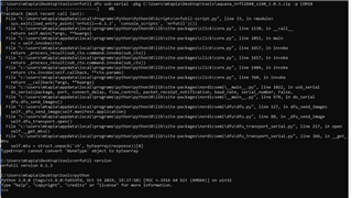

i am using nrfutil 6.1.0 in windows (i've installed it typing pip install nrfutil), i am using python 3.6.5 and when trying to serial dfu it shows the following error:
C:\Users\mtapia\Desktop\tools>nrfutil dfu usb-serial -pkg aquana_nrf52840_s140.zip -p COM9 -b 115200
[------------------------------------] 0%
File "C:\Users\mtapia\AppData\Local\Programs\Python\Python36-32\Scripts\nrfutil-script.py", line 11, in <module>
load_entry_point('nrfutil==6.1.0', 'console_scripts', 'nrfutil')()
File "c:\users\mtapia\appdata\local\programs\python\python36-32\lib\site-packages\click\core.py", line 1128, in __call__
return self.main(*args, **kwargs)
File "c:\users\mtapia\appdata\local\programs\python\python36-32\lib\site-packages\click\core.py", line 1053, in main
rv = self.invoke(ctx)
File "c:\users\mtapia\appdata\local\programs\python\python36-32\lib\site-packages\click\core.py", line 1659, in invoke
return _process_result(sub_ctx.command.invoke(sub_ctx))
File "c:\users\mtapia\appdata\local\programs\python\python36-32\lib\site-packages\click\core.py", line 1395, in invoke
return ctx.invoke(self.callback, **ctx.params)
File "c:\users\mtapia\appdata\local\programs\python\python36-32\lib\site-packages\click\core.py", line 754, in invoke
return __callback(*args, **kwargs)
File "c:\users\mtapia\appdata\local\programs\python\python36-32\lib\site-packages\nordicsemi\__main__.py", line 1015, in usb_serial
timeout)
File "c:\users\mtapia\appdata\local\programs\python\python36-32\lib\site-packages\nordicsemi\__main__.py", line 970, in do_serial
dfu.dfu_send_images()
File "c:\users\mtapia\appdata\local\programs\python\python36-32\lib\site-packages\nordicsemi\dfu\dfu.py", line 127, in dfu_send_images
self._dfu_send_image(self.manifest.application)
File "c:\users\mtapia\appdata\local\programs\python\python36-32\lib\site-packages\nordicsemi\dfu\dfu.py", line 88, in _dfu_send_image
self.dfu_transport.open()
File "c:\users\mtapia\appdata\local\programs\python\python36-32\lib\site-packages\nordicsemi\dfu\dfu_transport_serial.py", line 217, in open
self.__get_mtu()
File "c:\users\mtapia\appdata\local\programs\python\python36-32\lib\site-packages\nordicsemi\dfu\dfu_transport_serial.py", line 366, in __get_mtu
self.mtu = struct.unpack('<H', bytearray(response))[0]
TypeError: 'NoneType' object is not iterable
why can cause this? i have taken a look to some of the cases but there is no solution for that.
Thanks in advance for your support.
Manuel

  • the image is OK, actually i can serial DFU the image in Linux but not in Windows, the image is attached here, what i am doing is i have the COM9 used at the first time as debugging (using tera term) then after applying a CLI command that i created to set the device in dfu mode, once the device is in dfu mode, i am closing the tera term to have the COM9 not used and then using this command to serial dfu:
    the same steps and the same image i am following in Linux and it works OK.
    actually i did a test leaving the COM9 opened and the log is different you can see it in the attached file:
    C:\Users\mtapia\Desktop\pc-nrfutil-master>nrfutil dfu usb-serial -pkg aquana_nrf52840_s140.zip -p COM9 -b 115200

  • i updated python to be 3.8 and it does not works yet.
    below i am showing to you an Ubuntu screenshot which works OK following the same steps.
    can the issue be that my .zip image is being generated in ubuntu? does the .zip image should be generated in windows?
