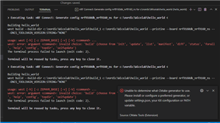

issues with nrf sdk and zephyr board files for nrf 9160dk
C:/nordic/v1.9.1/zephyr/boards/arm/nrf9160dk_nrf52840/Kconfig.defconfig:15: error: couldn't parse 'default BT && $(dt_nodelabel_enabled,reset_input)': macro expanded to blank string
Hey I am trying to write a program that sends integers from the 52 to the 91 of the nrf 9160 dk but I the nrf sdk is not working. I installed it through toolchain manager. I get no option to do pristin build, I am not able to open kconfig. I am not able to regular build either as shown below. You need anymore information let me know.

    In version 2022.4.219 of the VS Code extension the pristine build button was removed and there is instead a pristine build icon to the right when hovering over the build action.
    If you are getting an error when building, please upload the complete log from the build output with the error.
    Marte
    Try opening bash in Toolchain Manager (from the down arrow next to 'Open Segger Embedded Studio') and run the following command
    ncsmgr init-ncs
    If this returns an error, please open the file ncsmgr_init-ncs.sh (located in C:/nordic/v1.9.1/toolchain/ncsmgr) and add a line with sleep 3 between fi and git checkout "${ncs_tag}" so it looks like this:

    Save the file, then open bash and run ncsmgr init-ncs again as above.
    Marte
  • i got this error and it did not change after adding sleep 3
    Checking out NCS v1.9.1 ...FATAL ERROR: already initialized in C:\v1.9.1, aborting.
