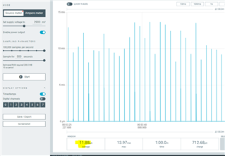

The online profiler says that if I use an external clock I can go below 10uA:
However, this looks impossible:
In the sdk_config.h, I made sure that I selected an external clock NRF_CLOCK_ENABLED=1 CLOCK_CONFIG_LF_SRC=1.

No matter what I do, I cannot get out of 10 A. Please tell me how can I turn on the LF ex clock on nRF52-DK?
