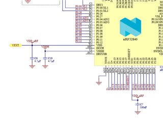

What should VDD level be on unprogrammed device?
We are supplying the nRF52840 from 5 V into the VDDH pin.  We are not using the USB interface, so VBUS is grounded.

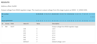

When we apply power to unprogrammed devices and measure the voltage on VDD, which is the output of internal regulators, we see a variety of values.  I've seen a few at 2.4 V, but also some at 2.1, 2.2 V or 2.3 V.  This doesn't make sense to me -- I would think they should be consistent unit to unit.  I've not used this particular Nordic IC before.  What should we expect to see?
