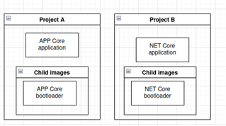

    Am you making two different projects: One for the APP core and one for the NET core?
    Or are you making one project for the whole nRF5340, like this?
    The second solution is the one I described in my previous post, and the one recommended for nRF5340.
