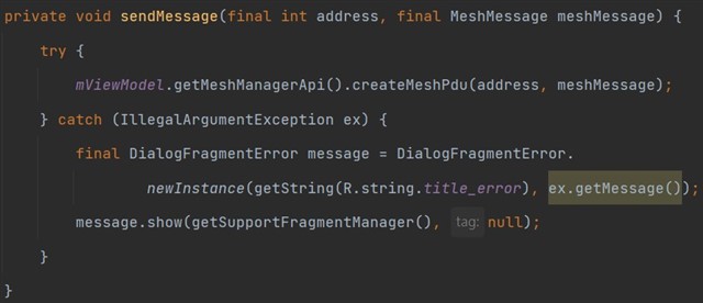

  • I believe I am using “group” as you mentioned instead of “broadcast”, since I use a comment (in Android-nRF-Mesh-Library) to send my packet to specified group address.

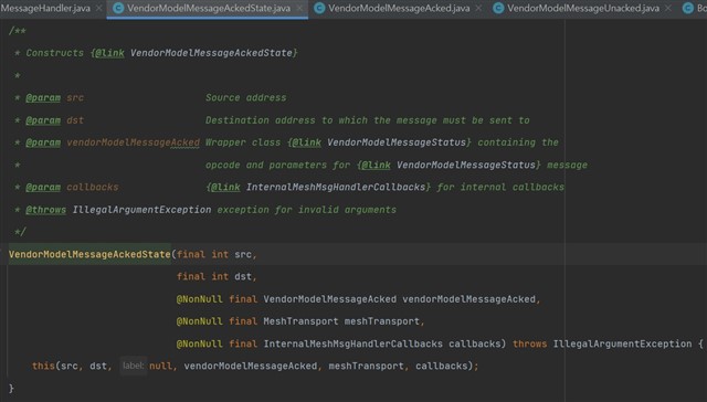

    It requires 4 times of retry number (TRANSPORT_SAR_TX_RETRIES_DEFAULT (4)) on phone to send a group message via a proxy node. And the message size is limited to 11 Bytes with successful sending.
    2.
    In above condition, when the packet size is over 11 Bytes for group address, it always fails.
    3.
    In case sending a group message from a nRF52840DK (generic onoff client), the result is successful even the packet size is up to 100 Bytes. Why not from a phone ?
    4.
    With unicast address from a phone to a node via a proxy node, and the retry number is set to 4 times, the packet size can be up to 100 Bytes. However, the performance is poor in sending time.
