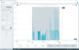

In the UDP project only enabling the NBIOT transmission with the CONFIG_LTE_NETWORK_MODE_NBIOT = y parameter the device is able to communicate and for each transmission of 10 characters the data are the following (see image):
TX time: 1.874 sec
Total consumption: 39,63 mC

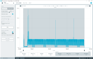

If I set the LTEM mode with the CONFIG_LTE_NETWORK_MODE_LTE_M = y parameter, the transmission time increases and the consumption increases by about 5 times (see image):
TX time: 6.945 sec
Total consumption: 210.83 mC
