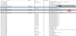

nrf9160 modem lockup after 24 hours, occasional random resets
We designed a custom board with nrf9160 (modem firmware v1.3.1) that runs an asset tracker type application.
The application uses both, LTE and GNSS:
  • logs sensor data at a defined rate to onboard storage
  • turns on GNSS every 15min to get a location (60s timeout)
  • connects to the cell tower every 15 min exchanges information with a server and disconnects (if no GNSS fix was recorded over the past 15min, then the cell tower information is used to obtain multicell location)
We are running into the following issues:
  • 4 out of 5 times, after exactly 24 hours the modem stops responding. AT commands are timing out and it appears that the application gets hung up when trying to disconnect from the network.
  • Occasionally, ~8seconds after disconnecting from the network the system resets without any error message.
I use the following two commands to connect and disconnect the LTE network:
  • lte_lc_func_mode_set(LTE_LC_FUNC_MODE_ACTIVATE_LTE);
  • lte_lc_func_mode_set(LTE_LC_FUNC_MODE_DEACTIVATE_LTE);
I attached a modem trace for the 24h lockup (sorry for the file size, its 24h and 15min long).
Here is a condensed version of the application log around the 24 hour mark:
