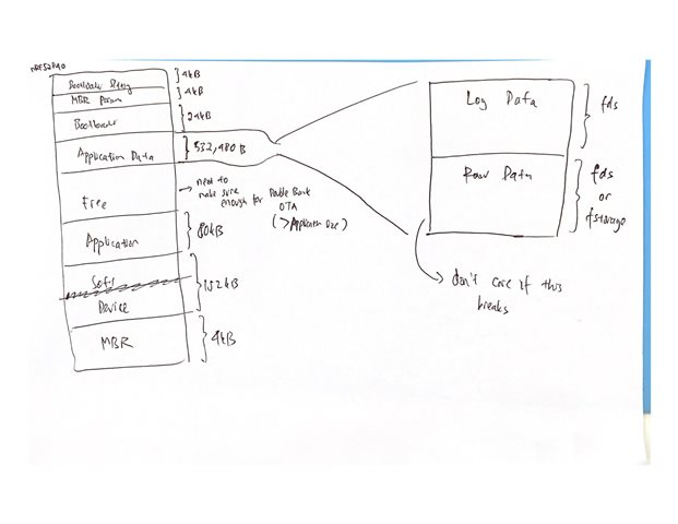

I've got an application where I want to store two types of log data in my memory flash that I want to send to server eventually via BLE mobile app.

Since fds doesn't allow you set a fixed addresses for your records, but only through flash_bounds_set() where I have set 130 pages with each page size of 4096Bytes, in total of 532480 Bytes. I understand that this is reserved for fds under APPLICATION DATA memory layout.

1. Would I be able to set 2 separate application data of fds not having them share the same boundaries? (e.g.  0x0000- 0x1000 - log data, 0x0000 - 0x2000 - raw data)
Since my raw data will invalidate a huge chunk of the flash addresses if I use fds, therefore potentially reducing the amount that I can write for my log data.
2. Would I be able to use fds and fstorage implementation at the same time?
I understand that fds used fstorage internally. I think with fstorage, I will be able to know the exact flash address of where my raw data will be stored all the time. It still depends on Question 1 of whether I can set certain flash addresses for certain type of data, since I don't mind if these part of the flash addresses become bad.
  • Currently, both log data and summary data will share the same fds space within its boundary just under different FILE_ID to identify what kind of data is stored
  • There is a way to move the FDS data space, so that you have some room between the bootloader and FDS to use as you like. The define in sdk_config is called FDS_VIRTUAL_PAGES_RESERVED.
    Then the FDS would only handle your log data, and you would declare a separate fstorage instance in the reserved space for your raw data.
  • Hi Ricco,
    I agree with Markku that you would just use FDS to store your smaller trunk of data and then define a 2nd instance of fstorage independent from the fstorage instance of FDS to handle  your raw log data.  The 2nd instance fstorage can have a different start and end address of flash for storage.
    If you support DFU and want to preserve the application data, the NRF_DFU_APP_DATA_AREA_SIZE configuration must cover both the flash areas of fds and 2nd instance of fstorage.
    As far as I know fds doesn't support storing a record larger than a Virtual flash page (which equals one flash page)
  • Thanks for the answer. Could I have more than 2 instance of fstorage, let say if I want to add another types of data logs with different boundaries?
  • Hi Ricco,
    I don't see any problem having multiple instance of fstorage. You just need to define each them using NRF_FSTORAGE_DEF() and call nrf_fstorage_init for each.
