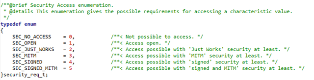

    So which one should I choose for the settings in the program?
    For each characteristic you define which security level you need in order to allow access to that characteristic. As long as the link has same or higher level, the peer is allowed to operate on the characteristic. (There are separate configurations for different operations, so it is for instance possible to require no security on say writing, but required MITM for reading. Or require just works for some characteristics, and MITM for others, etc.)

    If both peers final match is " Passkey Entry",which enum should i choose in security_req_t?
  • Hi Kai,
    It goes back to what I have attempted to describe:
    1. The security level of the link depends on the IO-capabilities of the peers (and if LESC is supported). The highest possible given the combined support is used.
    2. Each characteristic can requier separate specific security levels (from 1.) for each characteristic (and even separate for reading and writing).
    Tese two concepts are closely related. You need to understand the concepts in order to work with this, and it is basically as I have deescribed. If you need more understanding of this you can read up on Bluetooth security in general as this is a generic concept ant not specific to Nordic.
  • Hi Einar,
    So you mean that the security level set by the characteristic is preferably higher than the IO capability,right?
  • No. If you require higher security level on the characteristics than what you end up with on the link after pairing (based on IO capabilities), then you will not be able to access the characteristics.

    3. sec_xxx represents security level which defines the security of access characteristics.
    4. Each characteristics can have a different security level.
    5. The security level of the link must be the same or higher than the security level to access the characteristics.

    With passkey entry you will hav MITM, so up to SEC_MITM can be used, and the characteristic can be accessed. You can also use SEC_JUST_WORKS for instance, if you do not want to require MITM protection in order to access that specific characteristic.

    kai19960504 said:
    Why is data encrypted using the security level for just works?
    Just works is the term for pairing without any MITM protection (no passkey or numeric comparison). But as long as you pair, there will be a procedure that results in an encryption key (LTK) that is used to encrypt the link. If you don't want encryption, then do not pair or bond and set the characteristic security to open (SEC_OPEN).

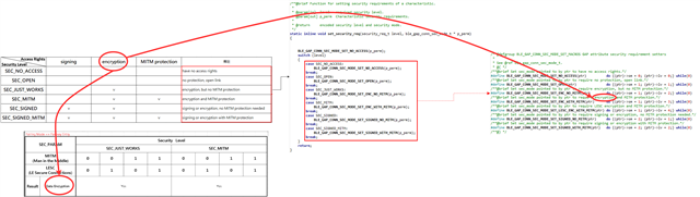

  • Hi Einar,

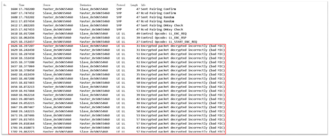

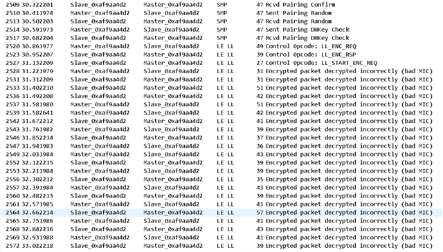

    I'm not sure we're talking about the encryption is same or not.
    My encryption means that Sniffer will send this message : Encrypted packet decrypted incorrectly (bad MIC),you can see the red frame,so I define it as data encryption.

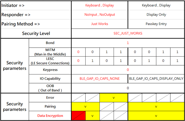

    Q1: regarding the encryption description in the code and my understanding from the experiment, are they mean the same things as the screenshot?
    Q2: according to my experiment, I'm confused why "Data Encryption" doesn't work with the configuration in red as the table?
    I believe we are talking about the same thing. (Encryption of the BLE link always happens the same way as long as encryption is used, regardless of how the pairing is performed.). The sniffer trace shows that the sniffer cannot interpret the packets after the link becomes encrypted, which means it does not have the LTK (either because you used LESC pairing of the sniffer did not listen in on the pairing procedure). Note that if you are using legacy pairing and you sniff the pairing the sniffer will get the LTK and can decode the packets even if the link is encrypted, so simply seeing that the sniffer can decode the packets does not show that the link is not encrypted. Instead, you need to see if if encryption is started (you se the LL packets right before the sniffer no longer can decode the packet in your sniffer trace), or look at the
    I don't understand the question, to be honest. As mentioned before, the configuration on the characteristics configure the security level required on the link in order to be able to access the characteristics. This does not control if the link is encrypted or not. (You can for instance pair and have an encrypted link even if all characteristics are open, there is nothing in the spec that prevents that, even if it would be unusual.)

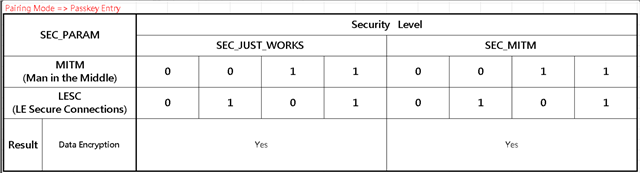

    I am not sure I understand the table. In what way does encryption not work? You can pair and encrypt the link without any I/O capabilities or any other requirements, as long as both peers support pairing and one of them initiates it.

  • Hi All,
    According to Einar's analysis, the final answer is organized here :
    1. As long as the IO Capability of Initiator / Responder follows Table2.8, the configuration will happen      automatically.
    2. Table2.8 tells you the security level that IO Capability can achieve, which defines the security of Link.
    6. Encryption of the BLE link always happens the same way as long as encryption is used, regardless of how the pairing is performed.
    7. The sniffer trace shows that the sniffer cannot interpret the packets after the link becomes encrypted, which means it does not have the LTK
