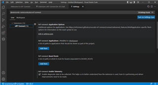

When I try and add a build configuration VS only presents me with boards it knows about and not my custom board.
How can I tell visual studio where to search for my board files.
SES let one browse for the boar directory.

    I am glad to hear that you found a solution.
    As you mention, you can also add board root paths in the extension settings. This is the same as the BOARD_ROOT variable in Zephyr, and therefore the extension expects that your board folders are organized as follows: <board_root>/boards/arm/<board_folder>. So if the path to your board folder is for example C:/ncs/boards/arm/my_custom_board, then you will need to give C:/ncs as path in the board roots setting.
