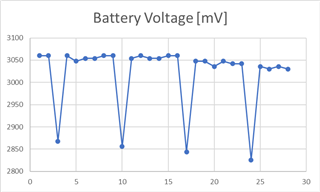

Does anyone know why I am getting low outliers on battery measurements with the SAADC?
I am measuring the battery directly every minute. Every seven minutes consistently, I get a low measurement. This goes on for months for the entire life of the battery. Here is a graph of a few minutes of the data:
During this test, there is no Bluetooth or any other connection. It is running on a custom board. Between measurements, it goes to System Off and gets started up again with a GPIO alarm from an external Real-Time Clock alarm. The exact same process is happening every time, as in, I am not (knowingly) doing anything different at the seven-minute mark.

    Can you please share what your battery_level_save() function looks like?
    I see that you are doing this on a custom board. Did you test it on a DK as well? Do you see the same behavior there?
    Are you powering anything else from your nRF?
    Did you try to measure the VDD voltage using another tool when the low level occurs? Does the voltage actually drop?
    Can you think of anything other in your application that can draw current around every 7 minutes?
    Edvin
  • After some deep searching of the code, I found a timing misalignment that caused a flash write to happen during the battery measurement every seven minutes instead of after the battery measurement.
    Thanks for your help.
