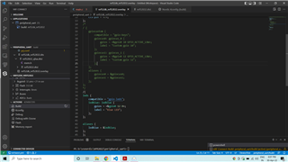

Custom GPIO pin in Overlay file
I want to add a simple GPIO pin that act as output pin, in the peripheral_uart example .
in main.c
#include <drivers/gpio.h>
//#define GPIO0_LABEL DT_PROP(DT_NODELABEL(gpiocus0), label)
//#define GPIO0_STATUS DT_PROP(DT_NODELABEL(gpiocus0), status)
//#define PIN 10
//#define FLAGS 0
#define LEDBLUE_NODE DT_ALIAS(ledblue)
#define LEDBLUE      DT_GPIO_LABEL(LEDBLUE_NODE, gpios)
#define LEDBLUEPIN   DT_GPIO_PIN(LEDBLUE_NODE, gpios)
#define FLAGS        DT_GPIO_FLAGS(LEDBLUE_NODE, gpios)
added these line main()
 const struct device *dev;
    bool led_is_on = true;
    int ret;
    dev = device_get_binding(LEDBLUE);
    ret = gpio_pin_configure(dev, LEDBLUEPIN, GPIO_OUTPUT_ACTIVE | FLAGS);
    for (;;) {
        dk_set_led(RUN_STATUS_LED, (++blink_status) % 2);
        k_sleep(K_MSEC(RUN_LED_BLINK_INTERVAL));
         gpio_pin_set(dev, LEDBLUEPIN, 1);//(dev, LEDBLUEPIN, (int)led_is_on);
        led_is_on = !led_is_on;
        k_msleep(500);
                printk("hello2");
I could not see any change in the GPIO pin.
I have tried followed the below links,
https://stackoverflow.com/questions/69873229/how-to-add-constants-to-a-devicetree-overlay
So, kindly show me any simple method to just turn on a GPIO and Read a pin from a GPIO by the way of OVERLAY FILE.

  • Thank you very much...its working.  DT_ALIAS setting configured properly; then starts working. In Prj.conf , i have only this line  CONFIG_GPIO=y.
    when writing a pin,
        dev = device_get_binding(LED1);
        if (dev == NULL) {
            return;
        ret = gpio_pin_configure(dev, PIN1, GPIO_OUTPUT_ACTIVE | FLAGS);
        if (ret < 0) {
            return;
    gpio_pin_set(dev, PIN1, 1);// when PIN=1; in the output voltage we get 0V, when PIN=0; we get 3.3Voltage in that
    And also in reading a pin;
        dev = device_get_binding(BUTT);
        if (dev == NULL) {
            return;
    ret = gpio_pin_configure(dev, PIN2, GPIO_INPUT| FLAGS);
    static int8_t readPinVal=0;
    readPinVal = gpio_pin_get(dev, PIN2); // when PIN2 =0; We get readPinVal =1; and vice versa.
    I do want in in reversal. How to do that.
