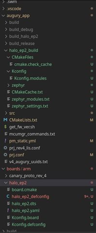

i have a project than works with nrf52840 and ncs (zephyr)
i want to have the same application running on nrf52832 as well, as part of a single code base strategy.
now i work with the nrf tool in for the vs code IDE,
i added a board and i a build configuration for the second board, but i don't understand how can both boards work with the same CMakeLists.txt, pm_static.yaml and prj.conf, since they are the same for both boards in the same application
obviously they require different partitioning since they don't have same memory size, that is just an example
any ideas on best practice for how to do that ?

    1. does my application dir should contain 2 pm_statics - pm_static.bord1.yml and pm_static.board2.yml ?
    if so, where do i define to which pm_static to go to ?, or they should, along with a CMakeLists.txt be inside the board1, or board2 directories ?
    same goes for prj.conf, do i need to have board1.conf and board2.conf in each board directory ?
    also, do i need to somehow re config the (green) files here:
  • 1. does my application dir should contain 2 pm_statics - pm_static.bord1.yml and pm_static.board2.yml ?

    one more thing, when i create another board_x.conf, then it is only reachable under application directory, if i put the .conf in each board directory the build does not find it why ?
    my CMakeLists.txt, looks like this with regards to boards and .conf files:
    set(BOARD_ROOT ${CMAKE_CURRENT_LIST_DIR}/../)

  • ziv123 said:
    if i do that and i remove the pm_static.yml and replace it with pm_static_board1.yml and pm_static_board2.yml, then i get an error during build
    You only renamed the file? The content is the same? If you don't set a pm_static file, how does the BUILD_DIR/partitions.yml file look like? Try taking that, and rename it to pm_static_baord1.yml and use that instead.
    Try doing a pristine build. How does the folder structure look like? You have a boards folder in the application directory with all the overlays and .configs? Or do you have a configuration/"board_name_x" directory ?
  • the yml issue was solved by adding this line to the CMakeLists.txt, don't know if it is ok practice or just a workaround because something else is not right..
    set(PM_STATIC_YML_FILE ${CMAKE_SOURCE_DIR}/pm_static_${BOARD}.yml)
    regarding the .conf i don't hold a .overlay file, just the .conf file inside the boards/arm/board1 directory where the .dts and .defconfig etc. are at, but if the .conf stay at the the directory where the CMakeLists.txt is then it is found.
