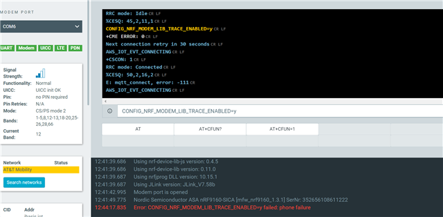

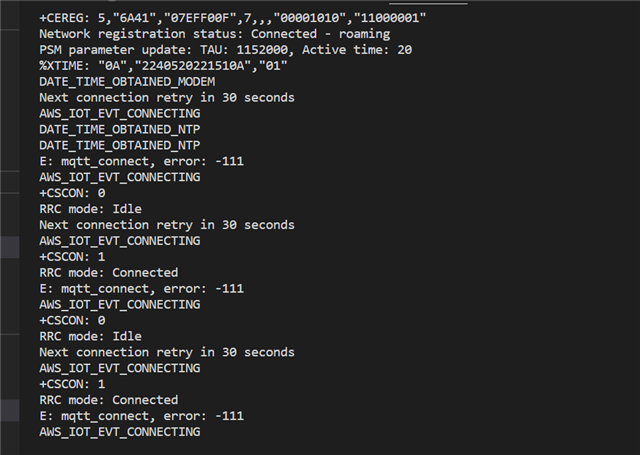

nrf9160 DK AWS IoT cloud connection issue
I used Modem firmware version 1.3.1
In order to connect the nrf9160 DK to the AWS cloud, I am encountering errors such as AWS_ IOT_ EVT _CONNECTING, when it should be AWS_ IOT_EVT_CONNECTED, as well as error -111 when executing the code. I attempted to use the trace collector v2 preview, but it did not work. I then attempted to add the line CONFIG NRF MODEM LIB TRACE ENABLE to my prj.conf, but this resulted in an error as well as before. Can you possibly assist me in resolving this issue by providing a step-by-step tutorial?
Best regards
Sobaha

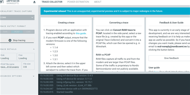

    Setting the option CONFIG_NRF_MODEM_LIB_TRACE_ENABLED=y in prj.conf would be correct. However, you should not put the same option inside the Link Monitor, as this is what caused the error.
    After you set this option in prj.conf, you should be able to use Trace Collector v2 to provide pcap log of the connection.
    Dejan
  • I am able to capture data using trace collector v2, but I'm not sure what I need to do next to resolve my problem. How do I get AWS IOT EVT CONNECTED instead of AWS IOT EVT CONNECTING? How do I resolve Error -111? The deadline is approaching, and I need to do this as quickly as possible. The fact is that I've been fighting this problem for about a month. You can help me out by providing a detailed step-by-step lesson this time so that I can figure out what's wrong. I've also provided a copy of my log file also capturing trace file.

    2022-05-02T17:08:07.218Z DEBUG modem << Next connection retry in 30 seconds
    2022-05-02T17:08:07.222Z DEBUG modem << AWS_IOT_EVT_CONNECTING

    2022-05-02T17:08:25.222Z DEBUG modem << E: mqtt_connect, error: -111
    2022-05-02T17:08:25.238Z DEBUG modem << AWS_IOT_EVT_CONNECTING
    2022-05-02T17:08:30.787Z DEBUG modem << +CSCON: 0
    2022-05-02T17:08:30.797Z DEBUG modem << RRC mode: Idle
    2022-05-02T17:08:31.022Z DEBUG modem << %CESQ: 41,2,4,0
    2022-05-02T17:08:36.847Z DEBUG modem >> AT+CESQ
    2022-05-02T17:08:36.873Z DEBUG modem << +CESQ: 99,99,255,255,2,39
    2022-05-02T17:08:36.879Z DEBUG modem << OK
    2022-05-02T17:08:37.220Z DEBUG modem << Next connection retry in 30 seconds
    2022-05-02T17:08:37.224Z DEBUG modem << AWS_IOT_EVT_CONNECTING
    2022-05-02T17:08:37.366Z DEBUG modem << +CSCON: 1
    2022-05-02T17:08:37.383Z DEBUG modem << RRC mode: Connected
    2022-05-02T17:08:37.389Z DEBUG modem << %CESQ: 46,2,12,1
    2022-05-02T17:08:37.618Z DEBUG modem << E: mqtt_connect, error: -111
    2022-05-02T17:08:37.636Z DEBUG modem << AWS_IOT_EVT_CONNECTING
    2022-05-02T17:08:40.935Z DEBUG modem << %CESQ: 51,2,16,2
    2022-05-02T17:08:43.228Z DEBUG modem << +CSCON: 0
    2022-05-02T17:08:43.239Z DEBUG modem << RRC mode: Idle

    2022-05-02T17:22:50.275Z DEBUG modem << 29 NRF_PDM              Non-SecureOK
    2022-05-02T17:22:50.277Z DEBUG modem << 30 NRF_I2S              Non-SecureOK
    2022-05-02T17:22:50.278Z DEBUG modem << 31 NRF_GPIOTE1          Non-SecureOK
    2022-05-02T17:22:50.281Z DEBUG modem << SPM: NS image at 0x20200
    2022-05-02T17:22:50.283Z DEBUG modem << SPM: NS MSP at 0x20018a50
    2022-05-02T17:22:50.286Z DEBUG modem << SPM: NS reset vector at 0x25e75
    2022-05-02T17:22:50.293Z DEBUG modem << SPM: prepare to jump to Non-Secure image.
    2022-05-02T17:22:50.499Z DEBUG modem << *** Booting Zephyr OS build v2.7.99-ncs1  ***
    2022-05-02T17:22:50.518Z DEBUG modem << The AWS IoT sample started, version: v1.0.0
    2022-05-02T17:22:51.914Z DEBUG modem << +CEREG: 2,"6A41","07EFF00F",7
    2022-05-02T17:22:51.941Z DEBUG modem << LTE cell changed: Cell ID: 133165071, Tracking area: 27201
    2022-05-02T17:22:51.943Z DEBUG modem << +CSCON: 1
    2022-05-02T17:22:51.945Z DEBUG modem << RRC mode: Connected
    2022-05-02T17:22:53.458Z DEBUG modem << +CEREG: 5,"6A41","07EFF00F",7,,,"00001010","11000001"
    2022-05-02T17:22:53.486Z DEBUG modem >> AT+COPS=3,2
    2022-05-02T17:22:53.487Z DEBUG modem << Network registration status: Connected - roaming
    2022-05-02T17:22:53.489Z DEBUG modem << PSM parameter update: TAU: 1152000, Active time: 20
    2022-05-02T17:22:53.491Z DEBUG modem << %XTIME: "0A","2250207122150A","01"
    2022-05-02T17:22:53.503Z DEBUG modem << DATE_TIME_OBTAINED_MODEM
    2022-05-02T17:22:53.505Z DEBUG modem << Next connection retry in 30 seconds
    2022-05-02T17:22:53.515Z DEBUG modem << AWS_IOT_EVT_CONNECTING
    2022-05-02T17:22:53.530Z DEBUG modem << OK
    2022-05-02T17:22:53.533Z DEBUG modem >> AT+COPS?
    2022-05-02T17:22:53.547Z DEBUG modem << +COPS: 0,2,"310410",7
    2022-05-02T17:22:53.548Z DEBUG modem << OK
    2022-05-02T17:22:53.554Z DEBUG modem >> AT%XCBAND
    2022-05-02T17:22:53.586Z DEBUG modem << %XCBAND: 12
    2022-05-02T17:22:53.587Z DEBUG modem << OK
    2022-05-02T17:22:53.596Z DEBUG modem >> AT+CGDCONT?
    2022-05-02T17:22:53.618Z DEBUG modem << +CGDCONT: 0,"IP","ibasis.iot","10.165.203.165",0,0
    2022-05-02T17:22:53.619Z DEBUG modem << OK
    2022-05-02T17:22:53.629Z DEBUG modem >> AT+CGACT?
    2022-05-02T17:22:53.639Z DEBUG modem << +CGACT: 0,1
    2022-05-02T17:22:53.646Z DEBUG modem << OK
    2022-05-02T17:22:53.838Z DEBUG modem << E: mqtt_connect, error: -111
    2022-05-02T17:22:53.848Z DEBUG modem << AWS_IOT_EVT_CONNECTING
    2022-05-02T17:22:53.992Z DEBUG modem << DATE_TIME_OBTAINED_NTP
    2022-05-02T17:22:54.459Z DEBUG modem << DATE_TIME_OBTAINED_NTP
    2022-05-02T17:22:59.560Z DEBUG modem << +CSCON: 0
    2022-05-02T17:22:59.585Z DEBUG modem << RRC mode: Idle
