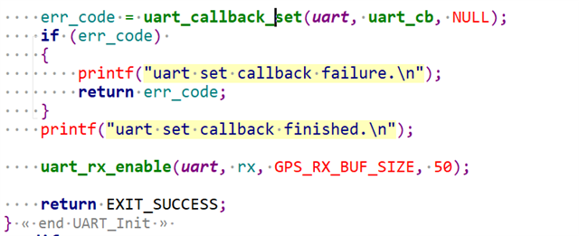

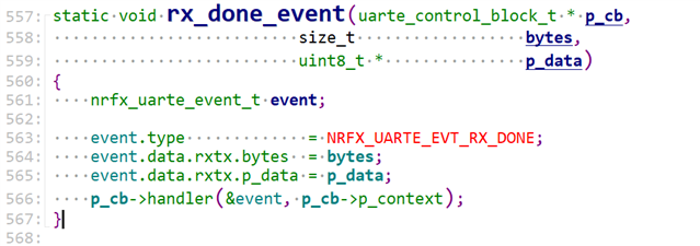

hi profess,
I re-compiling my project and run arm-none-eabi-addr2line.It's point to rx_done_event.
Ok, I don't have NCS v1.6.1. What does nrfx_uarte.c line 568 look like?
The reason is p_cb-<handle is NULL.
Ok, so you are trying to trigger a callback at NULL, then. Why is it NULL? Did you not set up a handler when you initialized the UART?
BR,
Edvin
I have used the uart_callback_set to set call back function.If don't use this function, what should I do?
