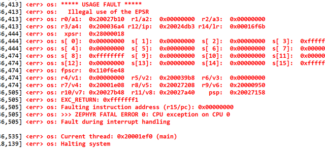

There are fault during interrupt handling when I run uart_rx_enable.I have merged SDK\nrf\samples\bluetooth\peripheral_uart\prj.conf to my project.
Try to use the tool arm-none-eabi-addr2line to look up what function that is on your R14/lr address. It should point to the line reporting the usage fault. It looks like it is in the main thread.
Remember that re-compiling your project may change the build and what functions that are placed here, so remember to use the R14 address from your log from your latest build.
What function does it point to?

hi profess,
I re-compiling my project and run arm-none-eabi-addr2line.It's point to rx_done_event.
Ok, I don't have NCS v1.6.1. What does nrfx_uarte.c line 568 look like?
