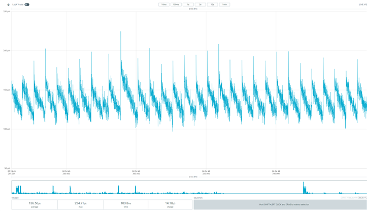

I have also a question about the source mode. I've used the "Source mode" measurement with Thingy91 and Circuitdojo nRF9160 Feather boards. In the measurements the PPK2 is connected to the battery connector of the board. I have also tested connecting 100uF + 10uF capacitors parallel with the PPK2 to the battery connector. With the Feather board the external capacitors have a significant impact on the avg current.
Is the PPK2 source to a battery connector accurate measurement method or would ampere meter mode with a real battery be more accurate?
I've attached pictures of the measurements. nRF9160 Feather with/without external capacitors and Thingy91 (v1.4.0) with/without external capacitors. The FW in the measurements is application idle & modem PSM.
Thingy91 + external capacitors:
Thingy91 without external capacitors:
Feather + external capacitors:
Feather without external capacitors:

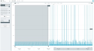

    I resurrect an old thread, but I discovered the same situation. Struggled with strange random 10..14 mA current peaks with my custom nrf52840 board when measruring with PPK2 in source mode, and they went almost away when I put capacitor over power input (max 200uA periodic peaks after that).
    Measurement without capacitor:
    Measurement with capacitor:
    Same firmware and same board, PPK2 settings are also the same.
    On my PPK2 is something off also with voltage regulator. I have set output voltage 3180 mV, but actually the output is 3728 mV.
