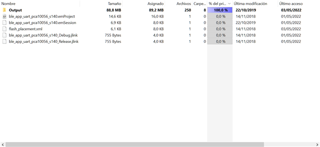

Can I know the minimum Flash & RAM memory I need in my module, to run an specific example source file, from which I have the following info:
Thanks.

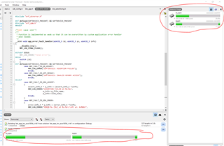

    You cannot see neither the flash nor RAM usage this way. You need to build the project, and then you will see both. Exactly how you see this depends on the toolchain you use, though. For instance, if building a nRF5 SDK project that use the SoftDevice using Segger Embedded Studio you get the memory usage stated after build has completed:
    The above shows the same info, but in the pane to the right you can click the arrow to get more info. Then you will see that in this case the lowest 0x27000 bytes (with this specific SoftDevice) of the flash are reserved, and that is because this is used by the SoftDevice. The rest is for the application. Note that you also need to consider space for persistent data (if relevant, for instance for BLE bonding), and for a bootloader (assuming you want that). For that, it could be good to refer to the memory layout from the bootloader documentation.
    Other toolchains will only give you the size of the binary you just built, and you will have to add the SoftDevice size your self (and BL and persistent storage, as always).
