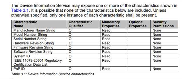

Hallo,
As I am developing a new product (peripheral acceleration sensor device) I would like to update the DIS service data with the following characteristics, Manufacturer Name string, Model Number String, Serial Number String, Hardware and Firmware revision string and System ID....How can I update those characteristics? Is there any standards in order to create those values? how can I get those values which suitable for my product....(I developed custom board with nRF52840)

    They are all optional, use those you feel are useful for your product. If you don't have a Organizational Unique ID, you don't need to use this.
    Sreejith Sundh said:
    Also confused from the GLS service that they defined MODEL NUMBER, but given this value to the SERIAL NUMBER STRING, why? How can I set those model number string?
    That looks like a bug in the GLS example actually.
    ble_srv_ascii_to_utf8(&dis_init.serial_num_str, MODEL_NUMBER);
    should have been
    ble_srv_ascii_to_utf8(&dis_init.model_num_str, MODEL_NUMBER);
