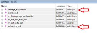

I was previously told that it was safe to block the BLE (SoftDevice) task created in nrf_sdh_freertos.c while waiting for internal flash operations to complete (See post linked above). Turns out, this isn't true. In my case, FDS (Flash Data Storage) events are received through the SoftDevice task. I was performing an OTA firmware update and blocking the SoftDevice task on a BLE message RX queue until my FDS events completed because page erase takes a long time (150+ msec). If the SoftDevice task is blocked, you never receive the FDS events and end up in a deadlock.
In summary, it looks like you can only block the SoftDevice task if what you are blocking on is not processed by the SoftDevice task itself. You also run the risk of delaying any other peripheral events that are also processed by the SoftDevice task which could have unforeseen systemic effects on your application. It looks like the only solution in my case is to artificially reduce BLE throughput since flash operations are a bottleneck, or have a really large BLE message RX queue.

    The softdevice_task in the nrf_sdh_freertos.c is designed to pull all the SDH events in the system. This includes BLE/SOC/ANT events for system that use those events. So you are right, having no time limit wait on  flash event (which is a soc event) dependency on a suspended task that is the only source of such event is a deadlock.
    You can try to split the stack events by splitting the softdevice tasks into
    softdevice_ble_task -> calling nrf_sdh_ble_evts_poll in nrf_sdh_ble.c
    softdevice_soc_task -> calling nrf_sdh_soc_evts_poll in nrf_sdh.soc.c
    The nrf_sdh_ble_evts_poll and nrf_sdh_soc_evts_poll are not designed to work independently without using overall SDH module registration. So you might have to do some changes there.
    I do not have any examples to show now, but seems like this would be a good non portal project for me to demonstrate when there is time. Unfortunately you need to split this yourself this time.
