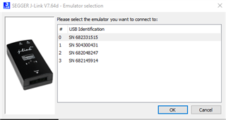

When multiple J-Link devices are connected to my computer, whenever I run nrfjprog without the --snr argument, I get a prompt to select the emulator like this:
Is there a way to retrieve the selection that was made after the nrfjprog.exe invocation? My use case is that I have a sequence of nrfjprog commands that need execution (e.g. recovery, programming, reset) and it is problematic that each time nrfjprog is started anew, I have to re-select the device.
The prompt itself is quite convenient if only shown once, but it would be helpful if I could actually find out which probe was selected...
    Unfortunately there is no simple way to select the previously selected device. In some cases you can run the commands together, for example --reset can be combined with --program. Another option is to create a script to make this easier. Exactly what you want the script to do is up to you, but here you have an example that you can use as a starting point:
    #!/bin/sh
    device_list=( $(nrfjprog --ids) )
    echo 'Select device'
    for i in "${!device_list[@]}"; do printf '%s: %s\n' "$i" "${device_list[$i]}"; done
    read device_nr
    family=$(nrfjprog --deviceversion --snr ${device_list[$device_nr]})
    nrfjprog -f ${family:0:5} --recover --snr ${device_list[$device_nr]}
    nrfjprog -f ${family:0:5} --program $1 --snr ${device_list[$device_nr]} --verify
    nrfjprog -f ${family:0:5} --reset --snr ${device_list[$device_nr]}
    This script takes the file you want to program as input, for example:
    sh program.sh _build\nrf52840_xxaa.hex
    It will find and display the serial number of all debuggers connected and let you select which one you want to use by using the index. Using the serial number it will find the device family, and in the end it will use the device family and serial number to run the recover, program and reset commands.
