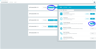

Not able to build VS code using nrf connect
I am having trouble to add the toolchain folder to the VS code setup.
The nrf connect for VS code does not pop up on the side at all to add application folder.
Tried to re install the nrf connect as well as VS cpde but did not help. Please advise to get the VS code setup build

    nRF connect for desktop works fine. I am not able to run the VS code and build the code. I do not see the nrf connect terminal icon in the side panel of my VS code

    Did you launch the toolchain manager in nRF Connect for Desktop to open Visual Studio Code? Opening it this way should prompt to add/install missing dependencies if there are any
