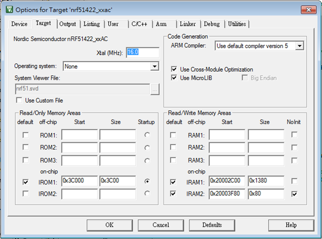

At first, I run dfu_dual_bank_ble sample code on 51DK. Here is the original bootloader address:
I got B module earlier than A. I change to custom board and change address:
It works well on B.

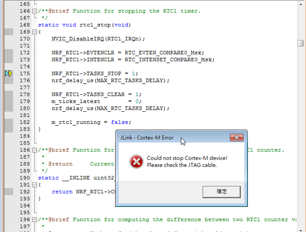

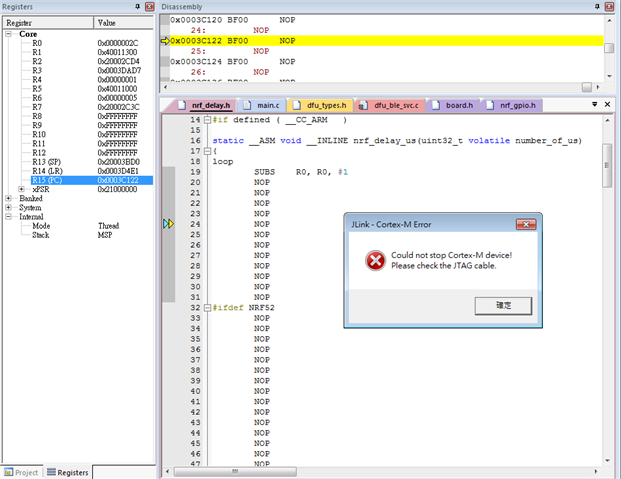

    If that doesn't work, then have you tried debugging? Try setting a breakpoint in the main() function of the bootloader. What happens? Is it reached?`Try to compare the working and non working device, and see if you see any difference in behavior.
    Yes, I just use debug mode for a while. It stops and shows this error when the code comes to nrf_delay.h.
    The other module, which can work well, stops at other place.
    I think there are answers about these errors in devzone, but I haven't figure it out yet.

    But you never see these JLink - Cortex-M Error when you debug your application (without bootloader)?
    When you try to debug the bootloader, does the JLink error come immediately, or does it reach the main() function first?

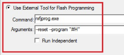

      Raytac engineer helps me to find out a little different.
    In my project which is transformed from SDK sample code, I use these argument setting:
    And these are Raytac engineer using (I was told that he uses SDK, too):
    So, I try the following 3 argument settings:
    1. --family NRF51 --program "#H"     ➜ I use at first
    2. --reset --program "#H"         ➜ Raytac uses
    3. --reset --family NRF51 --program "#H     ➜ I mix 1 & 2
    Both setting 2 and 3 lead modules to work.
    After I turn back to try setting 1, modules work, too.
    It seems there is something wrong if I keep using setting 1; and in 2 or 3 Keil fixes the problems.
