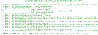

    It's normal to receive NRF_ERROR_RESOURCES , it happens when the softdevice buffer is full and you can not queue more notification or indication.
    What you need to do is to retry it after you receive BLE_GATTS_EVT_HVN_TX_COMPLETE event and then retry. It's explained in the documentation of the function sd_ble_gatts_hvx() in ble_gatts.h:
    Note that you should only reset the write_pointer when you managed to queue the data (err_code returns NRF_SUCCESS)

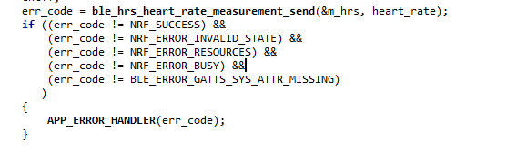

    I realized now that the NRF_ERROR_RESOURCES occurs when calling APP_ERROR_CHECK(err_code) (line 23 in the code above). When I comment out that line (what I don't want to do), the code works. So how can I resolve this?
  • Hi Moritz,
    You are getting there.
    The APP_ERROR_CHECK(err_code)  should only be used for err_code that are critical and the operation should be stopped.
    In your case NRF_ERROR_RESOURCES only means that the buffer of the stack is full. So you don't need to call APP_ERROR_CHECK() on it. Usually we we do this:
    In addition you may not want to use nrf_delay_ms(10) because it will just simply keep the CPU in busy loop and not putting it to sleep. You will end up having high current consumption. Instead you can put the CPU to sleep using  idle_state_handle();
    You don't even need the  while (ble_ready != true), you can use  if (ble_ready != true) then put the CPU to sleep with idle_state_handle();. The CPU will automatically wake up and continue when you receive BLE_GATTS_EVT_HVN_TX_COMPLETE  event.
