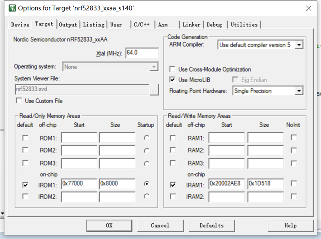

i can't understand how MBR jump to bootloader,  and how MBR konw the start address about bootloader.
or it's a fixed value at MBR. UICR.NRFFW[0]  ,default value 0x78000?
but i change the value to 0x77000 in keil ide, like below
amazing!it also can jump to bootloader (0x77000)。
for the first ,turn on mcu, MBR run, how it detect if a bootloader is present, and bootloader start addr, and what's the range about bootloader address
  • Hi Grandpa,
    The compiler can automatically detect the start address of the bootloader from your configuration using this:
    #define CODE_START ((uint32_t)&Load$$LR$$LR_IROM1$$Base)
    This CODE_START is assigned to BOOTLOADER_START_ADDR in nrf_bootloader_info.h
    Then the BOOTLOADER_START_ADDR is written to 2 places in flash:
    1. To UICR (UICR_BOOTLOADER_ADDR address 0x10001014)  using __attribute__ syntax , see nrf_bootloader_info.c
    2. To MBR internal setting page at 0xFF8, using a flash write inside nrf_bootloader_mbr_addrs_populate() function in the same file.
    The MBR internal setting has higher priority compare to the UICR.
    Every time you change the start address of the bootloader, make sure you do a chip erase so that these information can be written with a new value.
