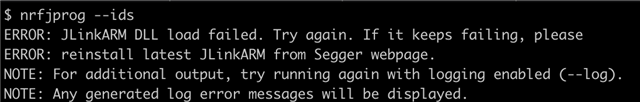

All of the tools use nrfjprog to interact with hardware using SEGGER JLink libraries. Some of these tools run natively in an native arm context, and some use Rosetta to emulate Intel architecture. The tools need to use nrfjprog with the version of the JLink librarary appropriate to the current architecture.
M1 JLink Intel JLink
nRF Command Line Tools (inc. nrfjprog) Yes No
nRF Connect for Desktop No Yes
nRF for VS Code extensions Partial (GUI elements) Partial (tasks run in terminals)
If the wrong library is used, a error is produced stating that nrfjprog can't load the library:
Solution
Install JLink for both ARM and Intel processors in seperate folders. Use a wrapper script for nrfjprog to specify the correct JLink library for the current architecture.

  1. Install nRF Connect for Desktop, nRF Command Line Tools and nRF for VS Code as normal
  2. Download and install SEGGER JLink ARM Version from www.segger.com/.../
  3. Move /Applications/SEGGER to /Applications/SEGGER_ARM
  4. Download and install SEGGER JLink Intel Version ("64-bit Installer") also from https://www.segger.com/downloads/jlink/
  5. Move /Applications/SEGGER to /Applications/SEGGER_x86_64
  6. Create a bin folder in your home directory
  7. Add /Users/USER/bin to your path, where USER is your username, by adding export "PATH=/Users/USER/bin:$PATH" to your shell profile/ rc file
  8. Create a wrapper script called nrfjprog in /Users/USER/bin with the following contents:
    #!/usr/bin/env bash
    arch=`arch`
    if [ "$arch" == "arm64" ]
    then
      SEGGER_ARCH=ARM
    else
      SEGGER_ARCH=x86_64
    fi
    exec /usr/local/bin/nrfjprog --jdll /Applications/SEGGER_${SEGGER_ARCH}/JLink_V764d/libjlinkarm.7.64.4.dylib $@
  9. Run chmod +x /Users/USER/bin/nrfjprog at a terminal to make the wrapper script executable
