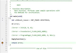

So using the SEGGER template, when I want to do some debugging to check these functions for some reason SoC restarting.
Even if I have in the Main function an empty function (EmplyFunction()) the SoC still restarting.

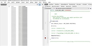

I requested technical support from SEGGER (see the attached email).
I the attachment you can find some screenshots and also the source code of the modified template.
I tried to find out the reason why is restarting by checking the RESETREAS register.
int u32Reset_reason = NRF_POWER->RESETREAS;
the u32Reset_reason is 5d. But I think is approach to check the RESTREAS register is not ok, because in order to check that register again i have to run again the code and then the debugger restarting the SoC.

until here is ok:
here the SoC restarted:
Source code of the modified template:
