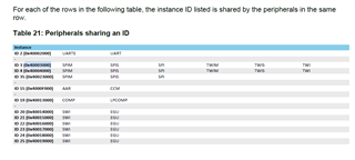

  • Hi Ziv,
    I think we need to go step by step.
    Have you managed to make any working firmware running on nRF52832 that accessing SPI + BLE without any RAM reduction configuration ?
    I don't think having basic SPI and BLE would exceed the RAM size of the nRF52832.
     I noticed that you have both I2C(TWI) and SPI enable. Please be aware that that they share the same instance ID and can't be used at the same time (for example SPI0 and TWI0). Here is from the nRF52832 spec:
  • hi Hung
    yes i am aware of that but thanks for mentioning
    i have managed to build and run and i will put my configs here to maybe help some searchers
