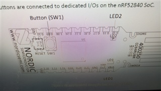

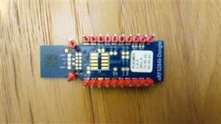

Here're some shots of the dongle

Please measure the voltage on SWDIO when you have set up the dongle for programming.
The log file should be located in c:/users/rixtronixlab/ where you called nrfjprog from.

I can see LD2 (RED) is on, very dim.
The correct IO voltage depends on how you are you powering the dongle (see Power supply options) and the REGOUT0 setting if you use high voltage mode.

I connected Vcc from J-Link to Vbus and GNd to GND,
It was working but now it's not,
Looks like the chip is faulty, do you reckon ?
Rixtronix
Do you reckon my internal regulator is faulty ? I used external 5V to Vbus, it's still not responding...??
Rixtronix
I can't pinpoint where the fault based on the information provided here.
What is the VTarget/Vtref pin connected to since it's 3.3 volts? It should be the same as the IO voltage, which you measured to be 2.2 volts
