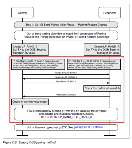

Is there any peripheral sample for OOB legacy pairing?
I'd like to know how to encrypt with temporary key(TK).
I checked the ble_hids_keyboard_pair_nfc sample in the SDK 17.1.0, but I couldn't find the part that generated LP_CONFIRM_R and STK from TK.
I would appreciate any advice.
