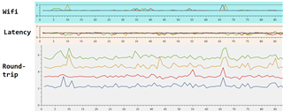

In our system, we've a PC connected to a PTX that communicates with multiple PRXs (via ESB), collect data and send it back to the PC (via cdc_acm, ACK + Payload). Our objective is to measure latency (how much time from the moment the PC requests data until it gets the data from all the PRXs devices).
I'm currently testing packets of 128 bytes (payload, not considering the protocol overhead) and I get the following results:
Wifi (transmit to ACK): ~0.97ms
UART Latency (response time from uart_irq_tx_enable until the callback is reached): ~0.36ms
Round-trip (on PC side, from request to reception of the PRXs payloads): ~1ms + ~1ms for each PRX device

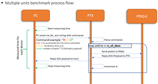

The test case was performed as follows:
  • PC requests PTX to collect data from all the PRXs
  • PC start to measure time
  • PTX parses the command
  • Performs the following for each connected device:
    • PTX sends to each PRX a request
    • PRX reply ACK+Payload
    • PTX copies the data to a buffer and trigger the UART IRQ
    • PTX UART callback is triggered (after delay of ~0.36ms)
    • PTX UART send serial Data to PC
    • PC measure time and plot it to the graph

  2. Are the results plausible (~6ms for my example to retrieve data from all 4 RX devices)?

    2. Yes, given there are no packet loss (e.g retransmi), in which case it likely will increase.

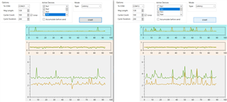

  • Great! Thank you for your proposal, I'll check this option of switching roles (PTX<=>PRX). It may suit our needs.
    Another option I've checked is to use 2x PTXs paired with 2x PRXs each.
    I've also gave distinct channels to each pair (1 and 50).
    I'm calling this function during the initialization stage:
    esb_set_rf_channel(50);
    I've managed to improve the performance by this. But we're aiming for better results.
