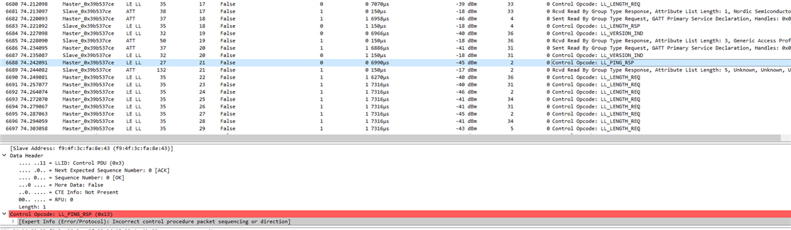

  • Hi Dani,
    It's the same issue as earlier, LL_PING_RSP sent without a LL_PING_REQ before that.
    I have checked internally and found other reports about this issue dated back to 2019. It usually happens with Qualcomm Bluetooth/Wifi chip . I don't know which exact version of your Tab A is but you can check.

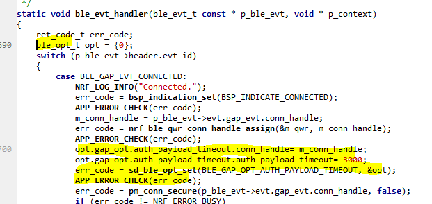

    We don't really have a workaround for that as it's the issue of the Central device. However, there were a workaround for another issue related to this I think it worth to try. Could you try to add the following code to your ble_evt_handler in main.c ?
                opt.gap_opt.auth_payload_timeout.conn_handle= m_conn_handle;
                opt.gap_opt.auth_payload_timeout.auth_payload_timeout= 3000;
                err_code = sd_ble_opt_set(BLE_GAP_OPT_AUTH_PAYLOAD_TIMEOUT, &opt);
  • Hi Hung,
    Already implemented and tested without success.
    I have proceeded in the same way as before with the TabA (Galaxy Tab A 2016, SM-T580):
    • Desinchrnozed Peripheral from TabA
    • Bonding and Connection with Peripheral: it connects perfectly
    • Manual Disconnection
    • Connection again with the already bonded peripheral: impossible to connect again
    Please, find attached the trace.
    Furthermore, in the code you have just sent to me, you call 'pm_conn_secure'. I do not use this call in my code. Is it required? (I think I already sent my implementation to you)

  • Hi Daniel,
    No pm_conn_secure() is not needed. It's used when the peripheral want to trigger bonding process. Usually the peripheral should let the central start the bonding process.
    If you test by turn off and on bluetooth on the TabA, would you be able to use the TabA to connect ?
    I think it's an issue with the TabA and not has anything to do with our chip/stack.
