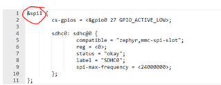

After that, I created an overlay file for the nRF52833 DK board for the SPI peripheral:
&spi1 {
        cs-gpios = <&gpio0 27 GPIO_ACTIVE_LOW>;
        sdhc0: sdhc@0 {
                compatible = "zephyr,mmc-spi-slot";
                reg = <0>;
                status = "okay";
                label = "SDHC0";
                spi-max-frequency = <24000000>;
I got the overlay above from this example.
Now my last questions:
2) The USB Mass Storage example uses the File System driver. How the FS and the SPI peripheral are linked? If I want use the spi2 instead? I suppose that the only link between the driver and the hardware is the label SDHC0 properties in the devicetree node. Am I worng?
