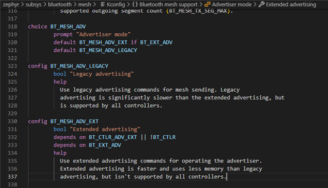

    It seems like the Legacy advertiser somehow is configured in. In the mesh Kconfig the used advertising bearer is defined as a choice:
    Meaning that it should not be possible to have both active at the same time.
    To verify that the extended adv is active you might search the build folder of the project for CONFIG_BT_MESH_ADV_EXT=y. If it is not there is something wrong in the prj.conf most likely.
    The build config can be found in [Project path]/build/zephyr/.config.
