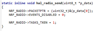

No START task used in the code
Datasheet says the sequence as mentioned below,
But the code given in the nordic playground does not follow the sequence mentioned in the datasheet, and the code still works !!!
The datasheet says to wait for the rampup to complete to issue the START TASK to begin the transmission. But the example code does not do this, could you please tell why ?
