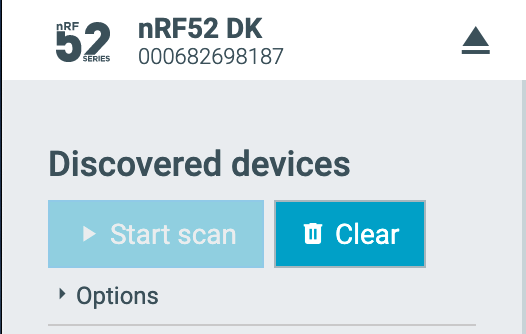

I'm having trouble when trying to connect nRF 52 DK with BLE app on nRF connect for desktop.
I can select device of my nRF52 DK, but cannot not scan any discovered devices, like the picture shows,

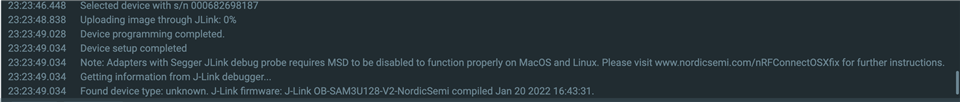

because of the problem shown below,
  • Note: Adapters with Segger JLink debug probe requires MSD to be disabled to function properly on MacOS and Linux. Please visit www.nordicsemi.com/nRFConnectOSXfix for further instructions.
  • Getting information from J-Link debugger...
  • Found device type: unknown. J-Link firmware: J-Link OB-SAM3U128-V2-NordicSemi compiled Jan 20 2022 16:43:31.

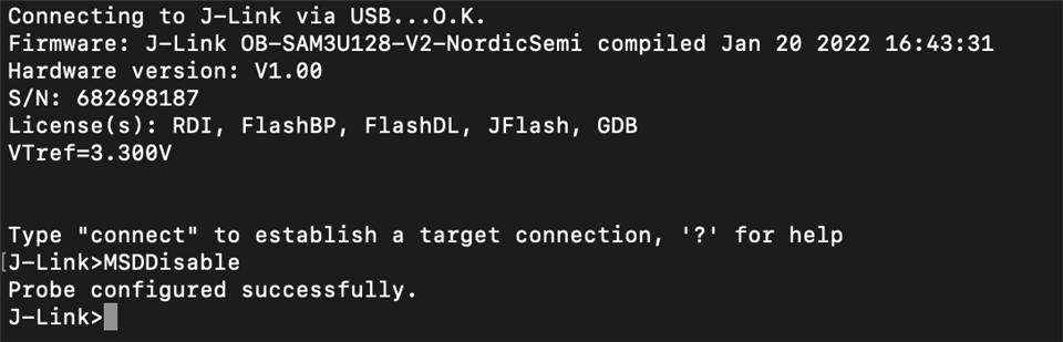

I've check this website www.nordicsemi.com/nRFConnectOSXfix, and tried to disable MSD using JLinkEXE(J-Link commander).
Then I tried to reconnect with BlE app, but it still doesn't work. How can I solve this problem?
