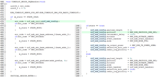

    I want to ask a question
    My project will switch ESB frequently_ TX and ESB_ RX
    Does switching take a little processing time
    Cause some radio data can't be received in time?
    Thank you
    The timing of the radio is given in the RADIO peripheral documentation: Radio timing
