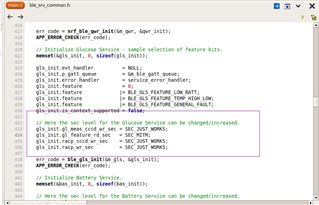

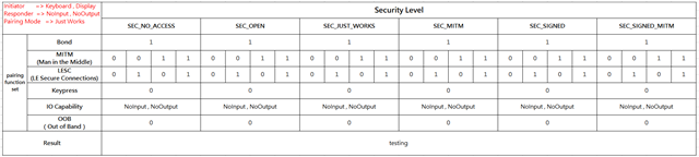

I'm using ble_app_gls and I want to remove LESC.
According  to my project => Lab10_PeerManager_CommunicationEncryption.zip

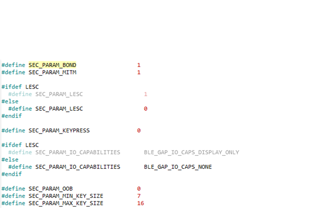

I have define a macro,the name is LESC, it used to switch whether to use the LESC function.
My pairing parameter settings are shown in the figure :
Why pm_sec_params_set(&sec_param) return invalid?
