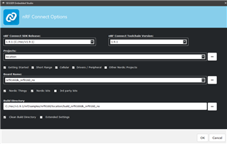

I use nRF Connect for Desktop download the NCS v1.9.1,  and i use SES open "C:\ncs\v1.9.1\nrf\samples\nrf9160\location" expample,  but when i want build this solution or build zephyr,  it's reprot error as below:  "core_cm33.h: No such file or directory"
do i need configurate something?  why is not right set configuration when download NCS v1.9.1 ?
