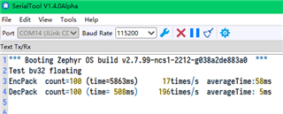

Is there a broadvoice32 sample project for nRF52840?
my problem is:
encode one frame will takes 20ms (but decoding only takes 2ms),
so it can't support 16bit 16khz audio in I2S.

    i got broadvoice source code from Smart Remote 3 reference design
    i created a project and build it for nRF5340-DK / nRF52840-DK,
    encode one frame take 58ms,
    I have no idea. I don't know where to start,
    this problem has bothered me for a long time;
    if possible, please help me look at the code project zip.
    bv32_floating.zip
    thanks

    thanks for reply,
    CMakelists.txt
    remove_definitions(-O0)
    add_definitions(-w)
    add_definitions(-O2)
    prj.conf
    CONFIG_NEWLIB_LIBC_NANO=n
    CONFIG_SPEED_OPTIMIZATIONS=y
    runing the same 58ms
    Best regards
