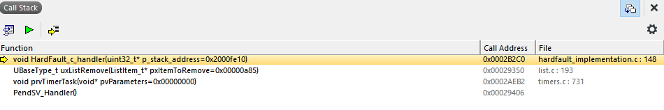

The problem is that we get the following  hard fault:
<error> hardfault: HARD FAULT at 0x00029350
<error> hardfault: R0: 0x00000A85 R1: 0x08F38168 R2: 0x00684088 R3: 0x0000000B
<error> hardfault: R12: 0x2000FE40 LR: 0x0002AEB7 PSR: 0x21000200
<error> hardfault: Cause: Data bus error (return address in the stack frame is not related to the instruction that caused the error).
The call stack is :
What am I doing wrong ?

  • Hi Ori,
    Thanks for your patience.
    It looks to me that the pxTimer might be pointing to an invalid instance of timer here in the uxListRemove.
    Can you put some logs in the timer to print the instances of the pxTimer.
    This might not be directly related to DFU but might be related to the way you are suspending and resuming all tasks. My best guess right now, is that the timer instance or the list instance within the timer is somehow invalid or corrupted. If that is the case, we need to find out how and when that happened.

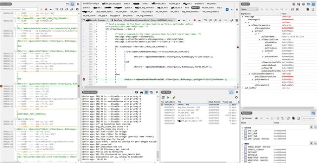

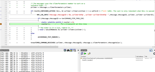

  • Hello Sushell,
    I have added xMessageID  to the prints at  prvProcessReceivedCommands
    just before  ( void ) uxListRemove( &( pxTimer->xTimerListItem ) );
    app: xMessage.xMessageID = 6, pxTimer=0x0x2000CE98 , pxTimer->pvTimerID=0x0x2002D2D8
    app: xMessage.xMessageID = 8, pxTimer=0x0x00000A81 , pxTimer->pvTimerID=0x0x1E200000
    The last two messages are coming from ISR (message ID 6 and 8)
    The problematic message is  : #define tmrCOMMAND_STOP_FROM_ISR ( ( BaseType_t ) 8 )
    Is there a chance that the the Softdevice has a timer ISR that triggers it ?
    (Even though the Softdevice is already disabled at that stage).
    Thanks in advance,
    Rafalino
